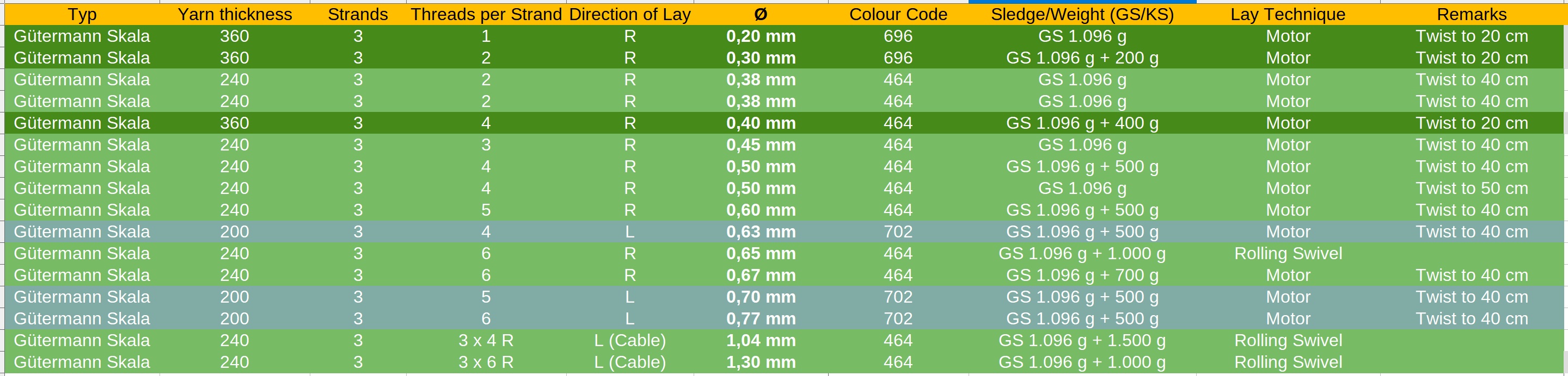

0,2 mm #scalerope - 3x1, Skala 360, color 702
[Image: 0fd3b4b3470b33679429cce00a7de6a1.jpg]

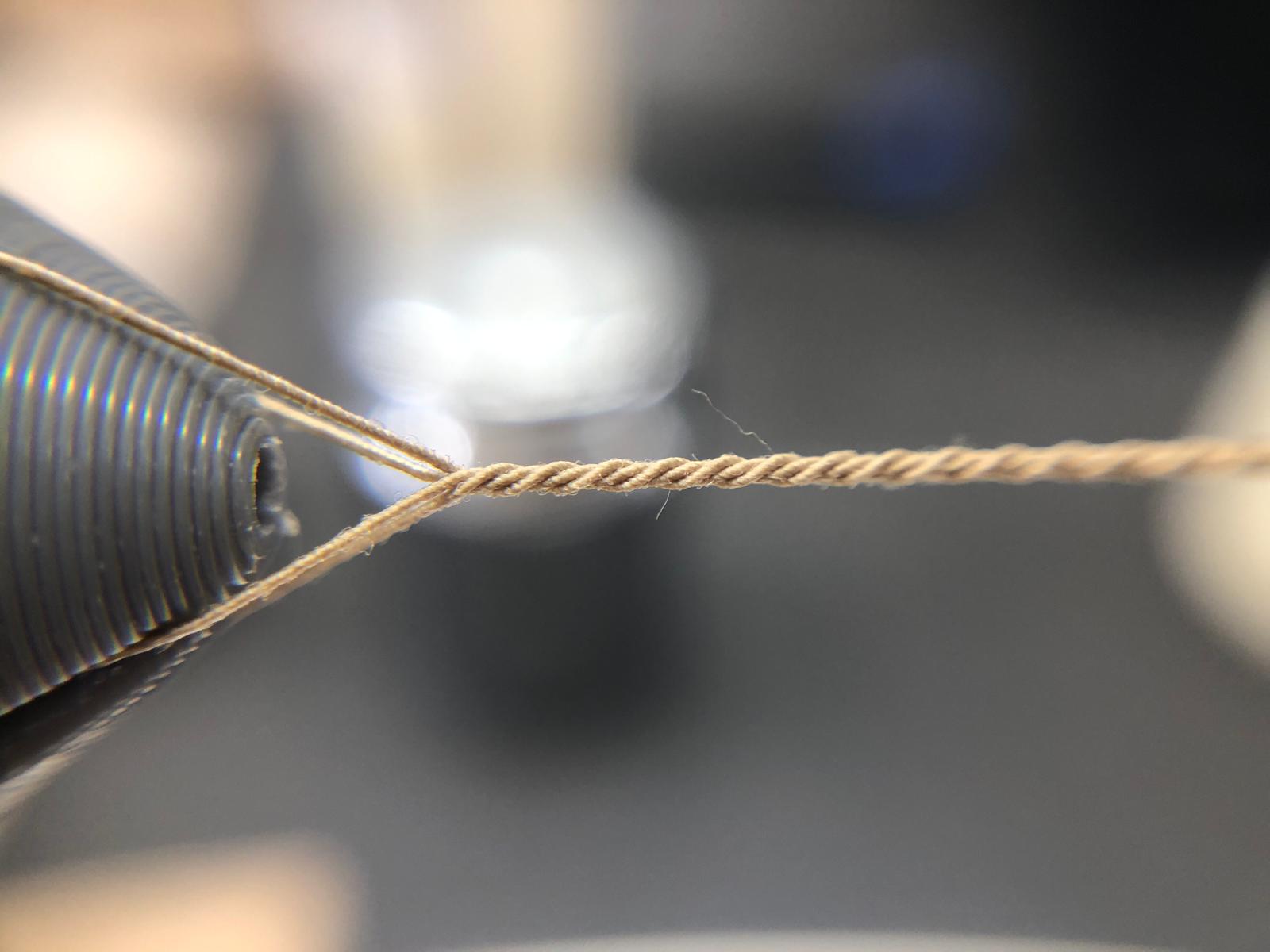

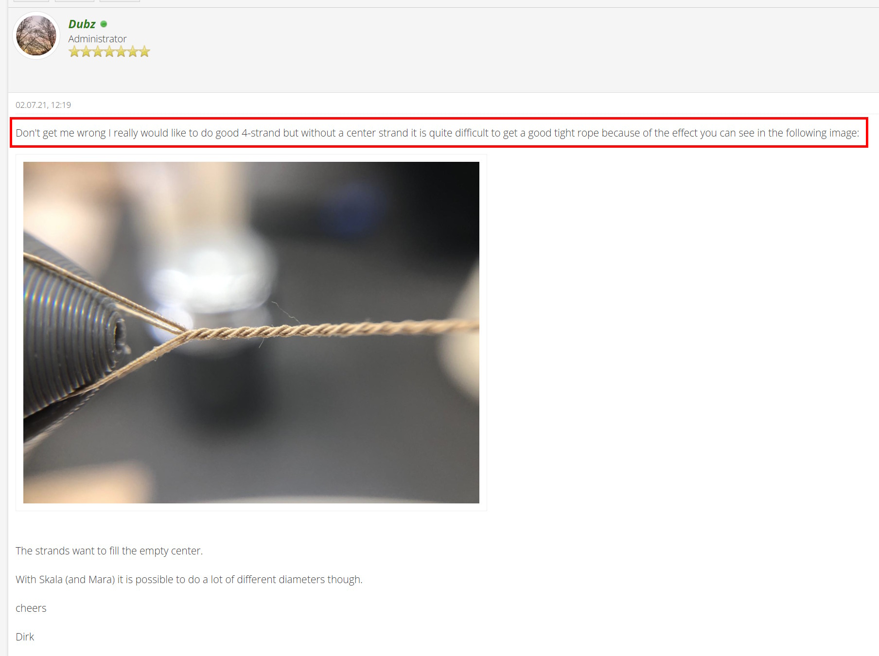

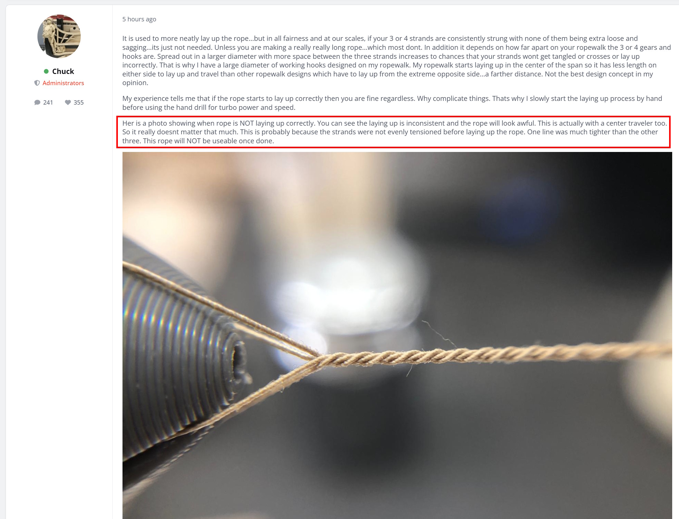

Mr Chuck Passaro, the god-like representative of the anti-piracy movement, defender of copyright, and moral authority for all the deluded, clearly doesn’t think much of his own moral compass. He’s simply using my image, and in a context that makes me look bad at that. In doing so, he demonstrates that he still lacks a fundamental grasp of the basics of rope-making. It is obvious that a 4-strand rope without a center strand cannot be layed properly, so using this as an example for his argument is simply embarrassing. But what can one expect from someone who still uses and sell left-hand hawser rope? I’ll probably have to write to NRG to protect my copyright. Embarrassing.
The lie
The original context.
